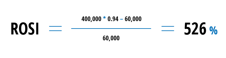

Example
Let’s estimate the ALE and mitigation ratio for a fictional scenario and use them to calculate the ROSI for a proposed security investment.
Suppose you know that your file servers have shared folders containing files with sensitive information that are accessible by everyone in your company. You know that this data overexposure increases the risk of data compromise and loss, but you don’t know the exact number or location of the folders. To reduce this risk, your company is considering investing in a solution for discovering sensitive data. To determine whether this investment is justified, you need to do the math.
You predict that if you don’t have the solution, you’ll have an average of 10 security incidents per year (ARO = 10). Each incident could lead to a breach costing around $40,000 in data loss, fines, lost productivity and lost business (SLE = 40,000). Therefore, the ALE is 400,000.
The proposed data discovery solution is expected to mitigate this risk by 94% (mitigation ratio = 94%). The estimated cost of buying and managing the solution is $60,000.
So you can calculate the using the ROSI formula from above as follows:
Calculating Return on Security Investment Sample ROSI calculation
Using this calculation, you can argue that this investment will save the company about $316,000 ($400,000 * 0.94 – $60,000), for a 526% payback.
